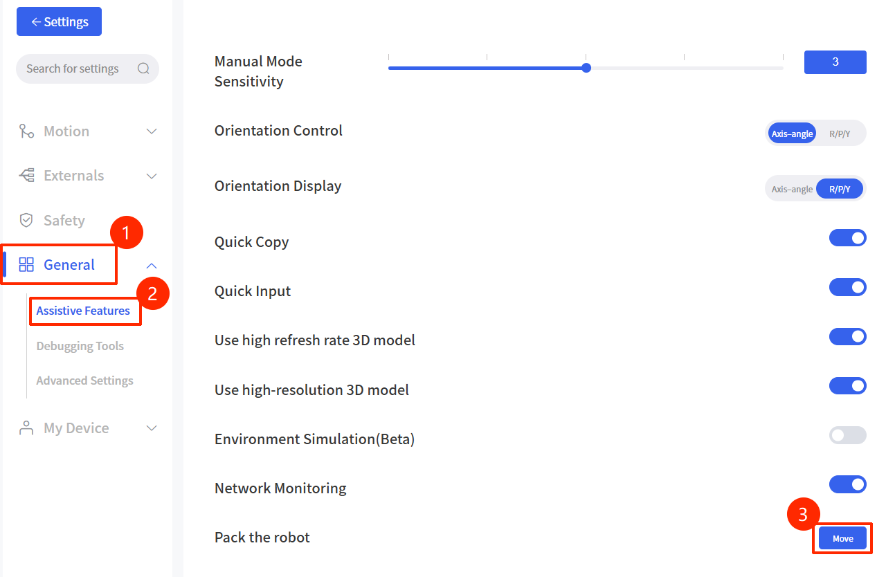

  • Move the robot to the packaging position by UFactory studio, then put the Lite6 robot and Control Box in the original packaging.
